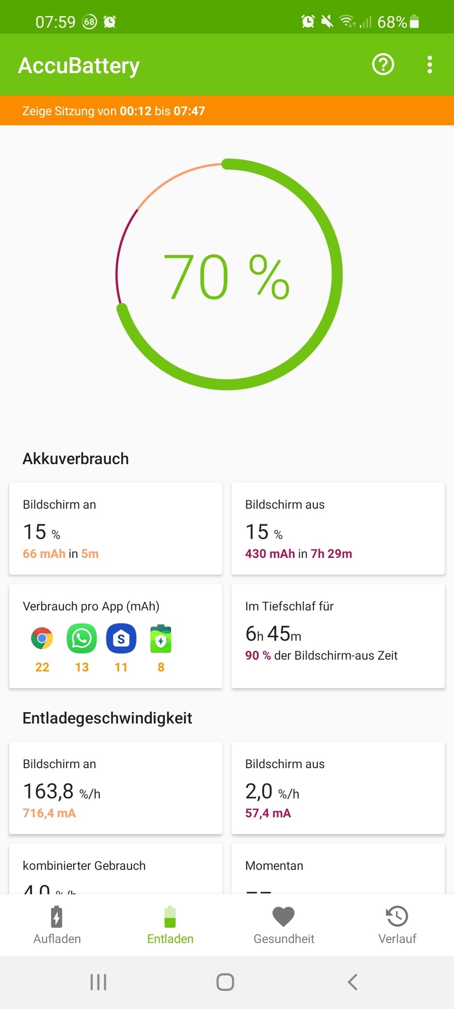

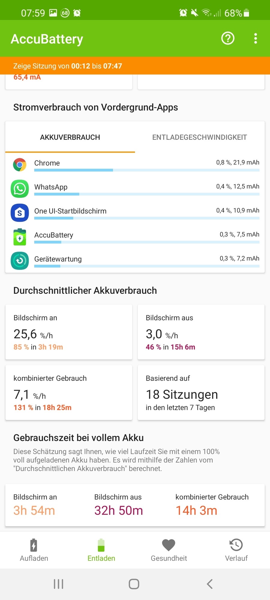

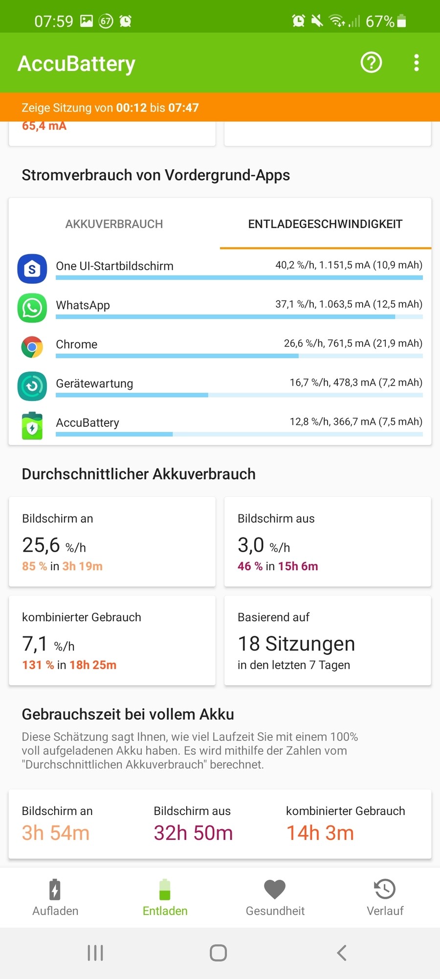

Hi,I just got my s21 on Friday and I am really disappointed at my battery life.My battery drops from 100% to 70% overnight which should not be the case. I downloaded a monitor app ("AccuBattery") to see if there is any faulty app but it doesn't really show any high battery draining apps (maybe I am just misreading it)
Does anyone else have this and knows a fix?
I already used almost every battery saving option in settings except the battery Saving mode itself because I won't get all the notifications I need. But even if I have it off, 30% overnight where I am definitely not using it is way to much.
I hope someone can help me.
Cheers
