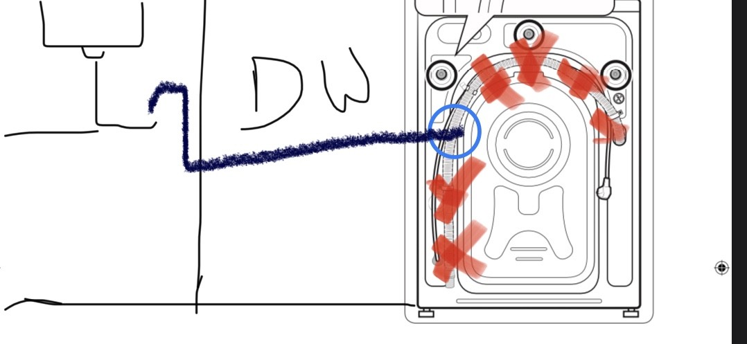

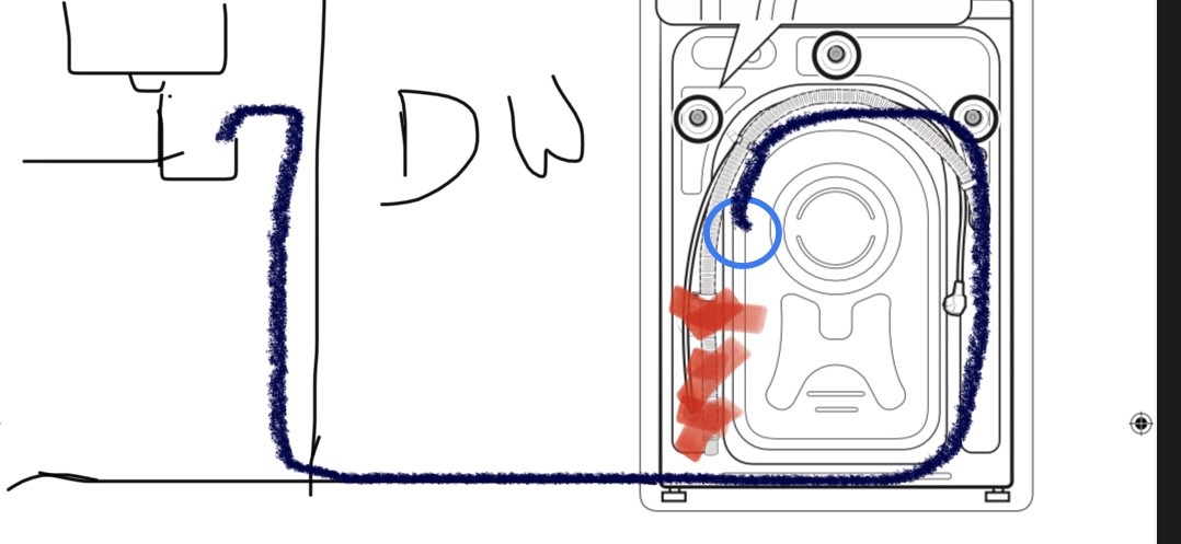

I have a new Samsung washing machine (WW80T534ATW/S2) and am currently planning my fitted kitchen. The sequence I would like to have is: sink-dishwasher-washing machine (from behind). I’m trying to understand what is best for the drain hose, having the two options below:
(Please bear in mind that I mirrored the picture from the manual so could edit it on the cellphone. The hose to be considered is the one drawn in blue).
option 1: buy an extension hose, use the whole curve path behind the washing machine and having the hose along the floor until it reaches the sink.
 Option 2: no hose extension and completely ignoring the curve path behind the washing machine. Having the hose in a slight decent way above the floor and connecting to the sink.
Which is the best option here? Can I use any of these options at all?
Thank you so much in advance.
Beatriz
    I would you se the curve behind the machine. I think the water pump will work better with the curve.
